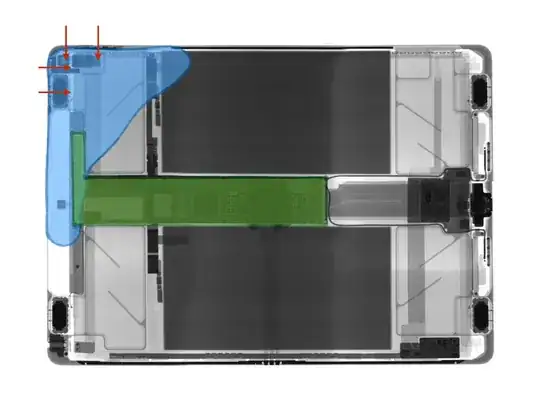

  1. I checked settings of my iPad and got it's exact model: A1584
  2. I Googled "A1584 teardown"
  3. On this website I found very detailed photos of the inside. I grabbed the case my iPad had on during splash - it still had the mark after the splash.
  4. I downloaded the x-ray photo and highlighted the pattern of the splash on it, I also highlighted where mainboard is placed and with arrows I marked potential entry points of water.
  5. I estimate, since the device was not submerged, only trace amounts of liquid could enter inside of the case and I think it's reasonable to say it couldn't reach the battery or mainboard.
  6. I estimate worst case scenario, potential corrosion could damage the the smaller circuit boards connecting power button, camera and volume buttons to the mainboard.
Reference on iPad teardown
My decision:
Taking into account following information:
  1. Device was not submerged and I estimate liquid couldn't reach critical components.
  2. Device is sealed and non-trivial to open, after closing it again might become less hermetic.
I decide to
  1. Not open it for cleaning of the motherboard.
  2. Prepare extra means of precaution for such events, purchased a case with better sealing.
Figure with marked liquid entry points, splash pattern and mainboard
