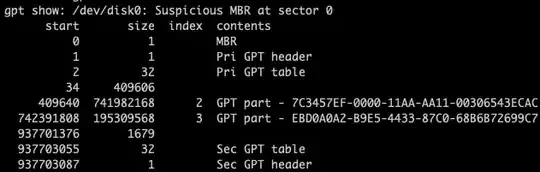

After trying to install a third operating system Windows 10 won't boot, displaying the message "Missing Operating System". My problem seems to be very similar to this one: Triple Boot: "Missing operating system" on Windows 7 partition after Ubuntu installation
However, I followed the steps provided in the solution and it still shows the same error. I have tried many other solutions and none have worked; I can't figure out what I'm missing.
diskutil list disk0:
sudo gpt -r show /dev/disk0:
sudo fdisk /dev/disk0:
Thanks in advance!

  • Isn't the first partition (disk0s1) supposed to be EFI? It isn't shown at all. Without that, I don't think the installation will be succesful. Also, I would suggest you to manually install Windows into disk0s3 after removing the Hybrid MBR. –  Jan 24 '19 at 21:06
  • I would need to know a little more before attempting to post an answer. What is the model/year of your Mac? Do do know if Windows was BIOS or EFI booting? Was the other operating system Ubuntu or something else? – David Anderson Jan 25 '19 at 00:23
  • It is a MacBook Pro (13-inch, Mid 2012), I understand they only support BIOS booting. The other operating system was Kali Linux. – Bernardo OS Jan 28 '19 at 16:13
  • As for disk0s1 missing, I didn't notice it was missing, do you know how to fix it? @pixelomer – Bernardo OS Jan 28 '19 at 16:37
You have a couple of problems.
  • Your EFI System Partition (ESP) is missing in your GPT partition table (so it has 2 partitions not 3). This will prevent Windows booting if installed in EFI mode.
  • Your hybrid MBR partition table is corrupt. Your APFS partition is marked active and has partition id type 07 (Microsoft) when it should have AF (Apple). Your BOOTCAMP partition is also missing. This will prevent Windows booting if installed in BIOS mode.
MacOS will boot directly from firmware, doesn't require ESP to boot (most of the time) and ignores hybrid MBR.

It is likely that the contents are still there - you just need to add it's definition to your GPT partition table. You have unallocated space from positions 34 to 409606. You need to add the partition back to the table in this space which you can do using gdisk which you can download from here https://sourceforge.net/projects/gptfdisk/
Install it, then open using sudo gdisk /dev/disk0 and you should see something like this :

Take option p to show GPT partition table and you should see your first partition starting at position 409640 (same as mine below). Note I deleted my EFI partition table entry here so as to look the same as yours but my second partition started at the same number as you as it is the standard position after a 200MiB ESP.

Now add the missing partition table entry with option n. You can take defaults but make sure you set partition type to EF00 which is EFI. The start position is important - try 40 as it is the default and also what your fdisk screen print shows. The end position doesn't matter so just take one less than the next partition.
