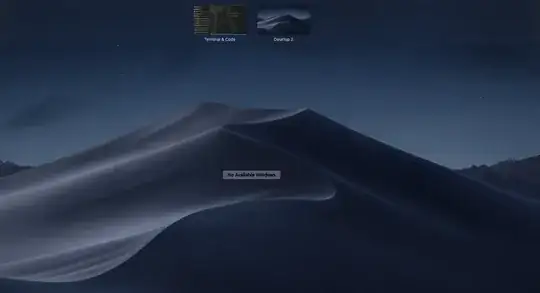

  • split the window in your computer screen (desktop 1)
  • resize them as you want
  • Zoom out (using your 4 fingers on the pad) to see all the desktops (windows).
  • pick, drag your window from your computer and drop it to the external monitor

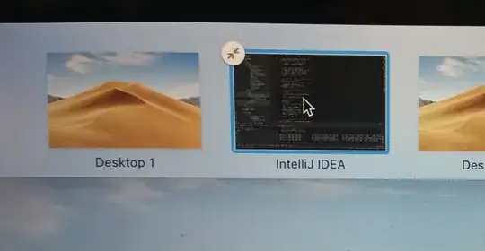

This just happened to me....
I got out of it by doing a three finger swipe up the mousepad This takes you to a view where you can see all spaces at once Then hover over the space with the expanded app - it will give you an option to minimize it. Click that.
