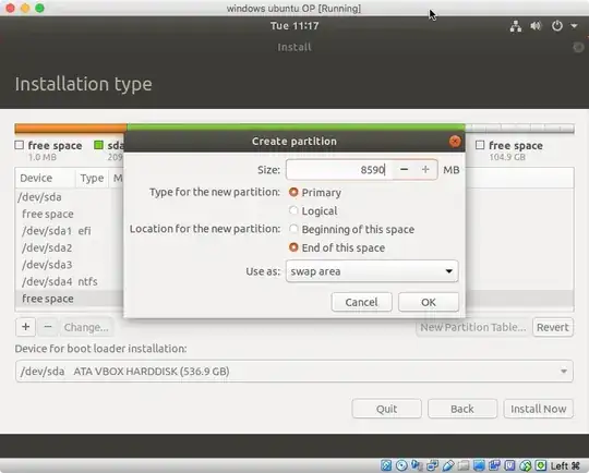

  3. Create swap space. For Use as:, select swap area. For Location for the new partition:, select End of this space. A typical value for swap space is twice the amount of RAM memory installed. Since my Mac has 4 GiB of RAM, the "Size:" field should be 8590 MB. The result is shown below. Next, click on the OK button.
    d2
