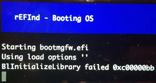

I have a MacBook 2015 running macOS High Sierra 10.13.4,I installed Windows 10 using Boot Camp. After that I created two partitions swap,root to do installed Linux Mint. Finally I installed rEFInd to manage the three OS's, but where reboot I can't access Windows. It's show message error "rEFInd - Booting OS Starting bootmgfw.efi Using load option '' BlInitializeLibrary failed 0xc00000bb ", How to fix it?

So here's how the error looks like, when trying to boot Windows from rEFInd:
