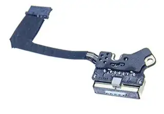

Your MacBook is dead.
Without putting hands on, I would guess that you have an issue with the DC-in board. It's the interface between your charger and the logic board and battery.
You have already done the requisite diagnostics:
  • Verified the your charger works
  • Verified that known working charger doesn't work on your MBP
  • Attempted to boot with battery disconnected
One final test you could attempt (if you have it available to you) is to use a battery from a known good MacBook Pro of the same model. If it boots, you will verify that the logic board is functional and confirm it's the DC-in board.
As far as the trackpad goes, it has no relevance here. It's ultimately a USB device and if the MBP has no power, the trackpad won't either.
If it is the DC in board, it's a relatively easy and inexpensive fix. iFixit.com has excellent instructions. It is still possible that it could be a logic board failure, but based on my experience that's it's unlikely.
Allan
  • 101,432
  • Thank you for nice advice. But can I verify is it dc-in board without another battery? I just have magsafe MacBook and some screwdrivers :) not a lot I know..I just want verify that laptop is working just problem with some small board.. – Mry Jan 05 '18 at 13:24
  • With a shortage of tools, I would probably bite the bullet and spend the $20 USD and get a DC-in board. If it fixes the problem, you're good. If not, it's the logic board which means a very expensive fix. One of the reasons I believe it's this board is that your battery isn't charging either. That's too many power rails to fail simultaneously (not that's it's impossible, just unlikely) – Allan Jan 05 '18 at 13:26
  • Okay thank you very much. By the way, can u explain how battery from another MacBook can help me if problem in dc-in board not in battery? Or do I miss something? – Mry Jan 05 '18 at 13:30
  • You have a dead battery that won't power the logic board. If you put a good battery in and it works, you've confirmed it's the DC in board. If it doesn't work, then it's the logic board – Allan Jan 05 '18 at 13:33
  • maybe you know why it can happened? – Mry Jan 05 '18 at 13:45
  • Any number of things from a power surge to a defective component. – Allan Jan 05 '18 at 14:02
