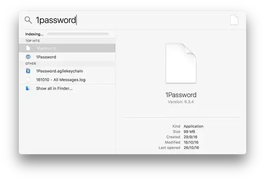

Spotlight has ghost entries for an USB disk that I cannot get rid of. It links to a bootable usb disk that is not currently connected. I have added that disk to Spotlight Privacy. Nothing I have tried unloading, reseting, deleting and reloading spotlight. Nothing.
These ghost entries do not show up when using Finder search.
Where are Spotlight caches stored other than .Spotlight-V100 ? There must be a place so that they survive cache rebuilding.
I am on 10.12.1 MBP and it is a clean install from two days. No use of migration assistant, etc. No external disk currently connected. Single partition.

  • The image is for illustration purposes. I have rebuilt the index several times already, letting it go to completion. It does not resolve the issue. The pointer for this ghost record stubbornly remains. – jakethedog Oct 27 '16 at 11:43
