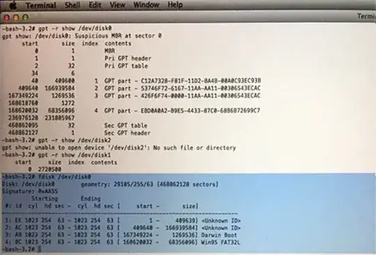

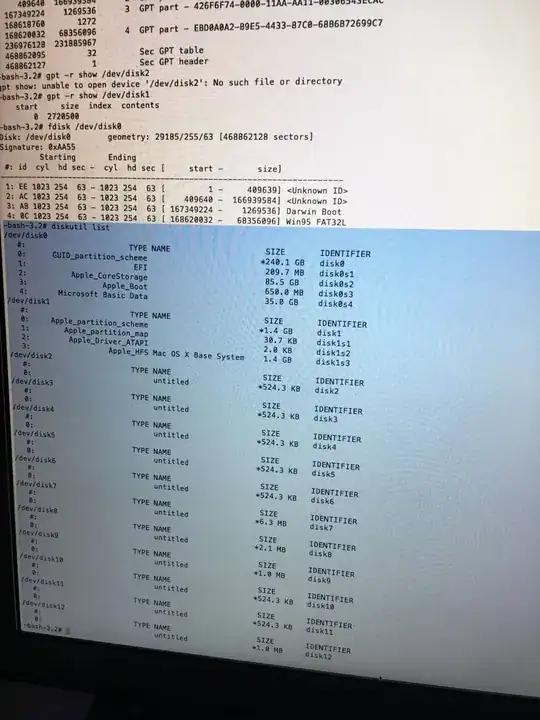

After checking the disk with disktutil list, diskutil cs listand sudo gpt -r show disk0 the following picture emerged:
- the disk had a MBR instead of a pMBR
- a CoreStorage Volume was configured but the Physical Volume was corrupted - no Logical Volume Family and Logical were available.
- No volume - neither OS X nor NTFS or recovery volume was working
