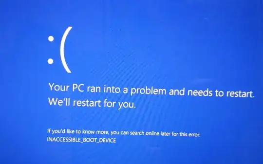

I have installed Windows 10 Pro in Mac OS X El Capitan using Bootcamp, restored the same to external USB 3.0 HDD using WinClone Pro. Now I am getting error when booting to Windows.
Steps followed:
  • Disabled SIP in Mac from recovery mode, using the command csrutil disable (this is requested by WinClone)
  • Installed Windows in Mac using bootcamp, installed drivers
  • Partitioned the external HDD
  • Restored the bootcamp installation to external USB 3.0 HDD using WinClone Pro
  • Removed the internal bootcamp installation using bootcamp
  • Restarted to external bootcamp installation
I am using MacBook Pro (Retina, 15-inch, Mid 2015).

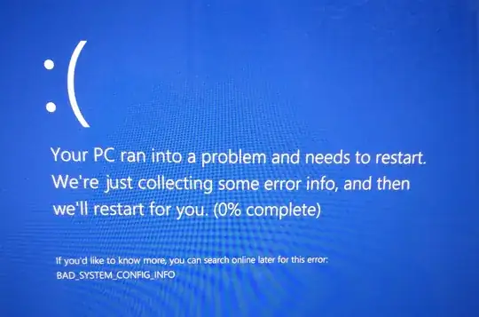

Tried with F8 key, then safemode and it gives like the below:
Reference Video

  • I have tried the both scenarios in WinClone as you explained. Both the times windows works fine with internal bootcamp installation and it is not working when restored into external HDD. – Anshad Vattapoyil May 12 '16 at 02:19
  • The second and third screen-shots are continuous to the first one, which is generated after trying with F8 key as directed in the first pic. – Anshad Vattapoyil May 12 '16 at 02:20
  • Thanks, it worked after editing registry. Please update answer it will be helpful for others. – Anshad Vattapoyil May 12 '16 at 14:38

  • @devo: Do you think my post about updating the BCD helped solve your problem? Or, was editing the registry the actual solution I should have posted? – David Anderson May 13 '16 at 13:51
  • Yes, updating BCD doesn't solve the problem. The registry have to be edited. – Anshad Vattapoyil May 13 '16 at 19:09
