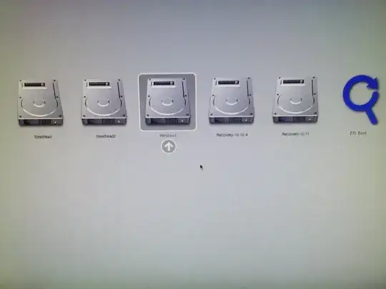

For example, I have rEFInd installed in a second 134 MB EFI partition on my iMac. (This happens to be the last of 9 partitions.) Additionally, I have Windows 10, Yosemite (on volume "Steelhead") and El Capitan (on volume "Steelhead2") installed. Below is a image of my Macs Startup Manager menu. (For a better view, click on the image or open in a new window.)
The icon can be changed by mounting the EFI partition and adding the icon file .VolumeIcon.icns to the root folder. A collection of these icons, for popular Linux and other operating systems, can be found here.
