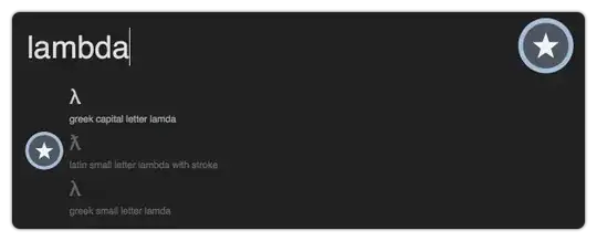

- Press Command ⌘+Control ⌃+Space.
- Type lamda into the search bar. Pay attention to type lamda instead of lambda.
- Your lamda should be there:
You might ask why it is spelt lamda not lambda.
