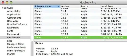

If you want to see what updates your system already has on it for a specific app, or any app for that matter, check out this How to view Software Update history? Q&A here on Ask Different. enter image description here
