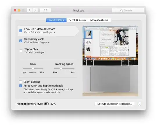

Another workaround, for the 2016 MacBook Pro:
System Preferences → Trackpad → Point & Click → toggle Force Click and haptic feedback (switch it off, then back on again).
(If necessary, use an external mouse to do this).
When I experienced this, it definitely wasn't a hardware issue, because it was still producing haptic feedback on click. Also, it would still register right-click events (two fingers) and force-click events.
