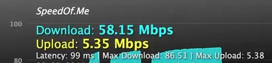

Speed Tests1:
WiFi speeds with Bluetooth-enabled, no devices paired:
three
WiFi speeds with Bluetooth-enabled, any device paired:
two

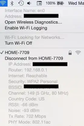

UPDATE:
Screenshot of detailed Wifi connection with a BT mouse paired. The SNR and Tx Rate are good:

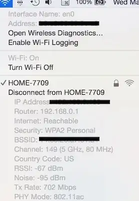

In fact, nearly identical without BT device paired:
