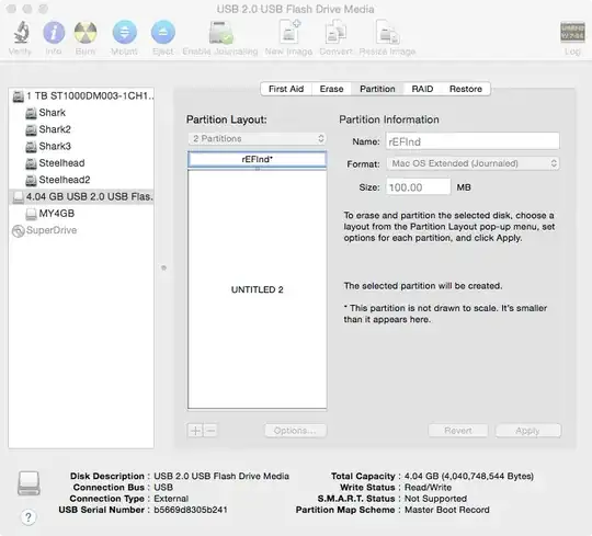

Insert a flash drive into a USB port. Open the Disk Utility application and partition the drive as follows.
The format of the second partition does not matter. I happened to use MS-DOS (FAT). Before applying changes, click the Options... button and make sure "GUID Partition Table" is selected.
Apply the changes and quit the Disk Utility.

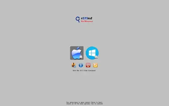

Restart the computer. You should boot to the rEFInd boot manager. The menu that appeared on my computer is shown below. (Hint: To get a better view, open this image in a new window.)
