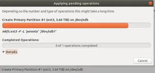

With VMWare Fusion 11.1.1 and Ubuntu 18.04 LTS I was able to successfully format a Seagate 4TB Disk connected via USB 3.0 on my Mac OSX 10.13.6 Laptop using gparted to the ext3 fileformat which then later can be read using Fuse ext2 solutions.
It took some 3 hours for the procedure ... gparted shows a progress bar in the meantime: Progress bar for gparted
Today (2021-01-17) I repeated the procedure and it only took a few seconds on a 4 TB SSD disk
