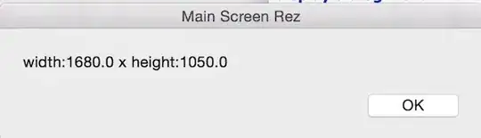

30
You can see the current resolution in the Display system preferences.
On a Macbook .. Retina, If you have scaled selected for resolution
Hover your mouse over the current scaled selection and the resolution will be shown.
If you have default selected for resolution then the resolution is not shown.
( I cannot check my non retina desktop at the moment)
But either way you could run this Applescript/Objective - C script from your Applescript Menu or from Script Editor.
    use framework "CoreGraphics"
    use scripting additions
    set sizes to item 1 of (current application's NSScreen's mainScreen's frame as list)
    set theRez to ("width:" & width of |size| of sizes & " x height:" & height of |size| of sizes) as string
display dialog theRez with title "Main Screen Rez" buttons "OK"
markhunte
  • 12,242
  • I save the code to test.scpt and run it from terminal with osascript test.scpt and get resolution.scpt:182:187: execution error: Can’t make width of |size| of {0.0, 0.0} into type Unicode text. (-1700) – Timo Jan 09 '24 at 14:40
