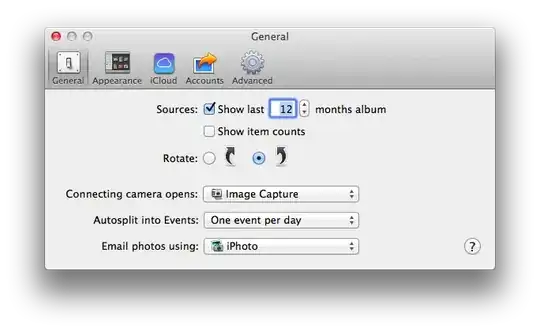

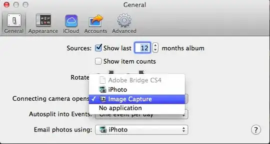

You have to open iPhoto, go into iPhoto Preferences and next to Connecting camera opens: select No Application.
- 301
The only downside will be that this applies to all devices and if you want to download pictures using Image Capture you will have to open it manually, which can be easily done from Spotlight. – JoshT Aug 09 '14 at 06:41
1I hear ya. I don't use it myself. Used to, but not anymore. The other option is to disable it per unit on image capture itself. There's there's a button on the lower left corner of the program. Hope it helps. – JoshT Aug 10 '14 at 02:01
