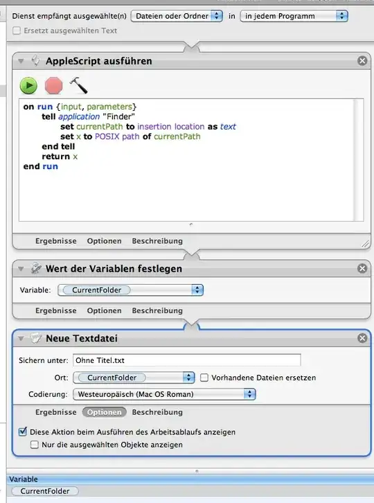

There is a workaround using Automator and Applescript. I tried it out; it works. The only shortcoming is, that you have to click on a file in the folder in order to execute the script.
How to create the service
Launching Automator and select Service. In the Automator main window at the top right, set the Service Receives Selected drop-down to `Files or Folders. Drag the following actions into the work area:
Copy and paste the following script into the code box and compile the code clicking the hammer icon.
on run {input, parameters}
tell application "Finder"
set currentPath to insertion location as text
set x to POSIX path of currentPath
end tell
return x
end run
Below that block, insert a new object Set Value of a Variable (in the Utilities section). Click the Variable drop-down and create a new variable calling it CurrentFolder.
Then, add a New Text File action (from the Text section of the Actions library). Drag the variable you just created (CurrentFolder) from the Variable panel at the bottom of the Automator window to the Where section of the New Text File action.
Click the New Text File's Options button and select Show This Action When the Workflow Runs. This will allow you to specify the name of new files.
Save the service and give it a name (e.g. Create New File).
Try it out in Finder going to the folder where you want to create a new file. Control-click on an existing file within that folder and select Create New File from the Services submenu. A dialog appears asking for a filename. Insert a name with file extension and click Continue. The new file should be there.
Here is a screenshot of the Automator job (sorry my Mac is German, but I guess you'll understand):
