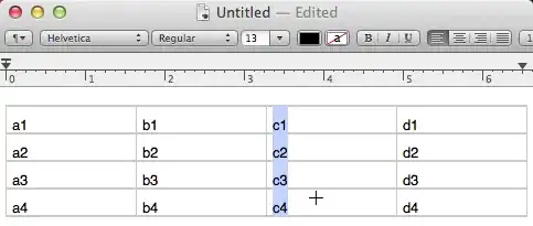

Let's say you want to delete column "c" below:
Hold down Option to mark the contents of the column (note that the cursor changes shape to a cross):

Thanks jaume. On my MacBook Pro, I had to press fn+delete while doing Step 4. Then the remaining columns were automatically resized so that the table continued to fit the entire width of the window, so that I didn't have to do Step 5. – pacoverflow Feb 05 '14 at 07:10
Thanks for sharing the fn+delete trick, I've added it to the answer and deleted step 5. – jaume Feb 05 '14 at 07:38

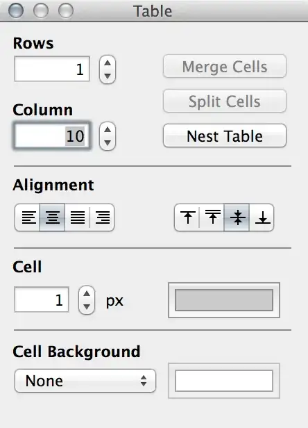

If it's the last column in a table, you can reduce the number of columns in the Table inspector, available from Format → Table…
