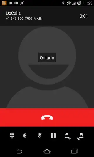

Once that time passes, it goes to the actual call where I can see the phone number, the contact picture (if available), the drop-call red button, etc.:
The Actual Call Screen after the Spinning Wheel
The Actual Call Screen after the Spinning Wheel (click image for larger variant)
