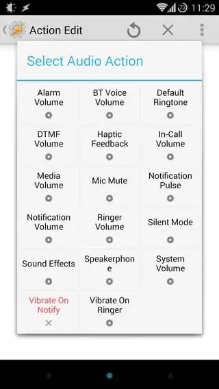

I see a related question but I do not see an applicable answer to my exact situation. I want to turn off vibration on notifications, without diabling notification sound along (so notifications should still play sound, just not vibrate).
I'd like to do it using Tasker. @Izzy recommended the "Vibrate On Notify" toggle but that doesn't seem to be available for me; unsure as to why (see image below).
I'd be open to installing Xposed Frameworks module if needed. Any ideas?
tasker window
Tasker window (click image for larger variant)

  • Have you tried Tasker's Vibrate On Notify action? From the Tasker manual: Whether to vibrate with a system notification. I've not tried it, but it sounds fitting. – Izzy Mar 06 '14 at 16:25
  • @shub but wouldn't that also suppress notification volume? As far as I understand the question, OP only wants to turn vibration for notifications off, not volume. – Izzy Mar 06 '14 at 16:27
  • @Izzy correct; I'd like to turn it off without going into silent. I looked at the mentioned tasker option but it is not available to me for some reason. Looked promising. – Belmin Fernandez Mar 06 '14 at 16:32
  • Yeah, some options seem to be device specific. I've got some of those as well. Usually this means the device doesn't support that. – Izzy Mar 06 '14 at 16:37
  • Have you tried the search function in the Xposed modules repository? A quick check found no exact matches, but some modules which might include it. – Izzy Mar 06 '14 at 16:44
  • @Izzy yes, did a search on Xposed and didn't find anything applicable. – Belmin Fernandez Mar 06 '14 at 16:52

Install Vibration Tuner Xposed module and set "global vibration strength" to 0%.
Compatible with at least Android 5-7 (I don't personally own a device with Oreo installed).
