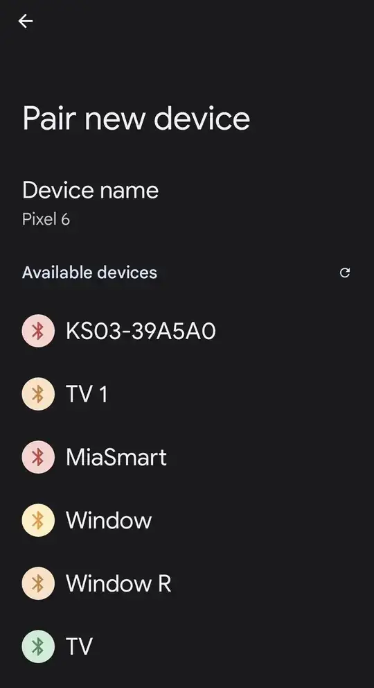

I wonder how I can get a notification when a Bluetooth device stops being accessible by my Android phone. I use Pixel 6 + Android 12.
Example of list of Bluetooth devices that are accessible by my Android phone:
When a given device (e.g., "TV") disappears from the list, I'd like to receive a notification.

    You'll notice when a connected device is no longer available. To have notification for devices that were in range and no longer are isn't possible. There never was a provision for such event. Just imagine the nightmare it would be if it happened for each device you come in contact briefly in any given day. – ChanganAuto Feb 04 '23 at 05:35
  • @ChanganAuto thanks, in my case, I'm just looking for a way to get notified for just a single Bluetooth device (not all Bluetooth device). – Franck Dernoncourt Feb 04 '23 at 05:48
  • @ChanganAuto it is possible to create an app which can periodically scan nearby Bluetooth devices or only user-defined Bluetooth devices, and alert the user if a device is longer available since the last periodic scan. See docs: https://developer.android.com/guide/topics/connectivity/bluetooth/find-bluetooth-devices – Firelord Feb 04 '23 at 19:26
    @FranckDernoncourt Tasker has BT_NEAR profile/trigger option. If you have Tasker already or if you can give it a go to its trial version than that profile/trigger might solve the problem for you. You'll have to adjust the timings at which to run a periodic scan, and than as an action for that profile you can setup a simple notification as an event reminder. – Firelord Feb 04 '23 at 19:39
  • @Firelord Yes, you can program almost anything in software. – ChanganAuto Feb 04 '23 at 22:25
This can be done using Android App Tasker. Here is a link: Tasker: Run a task when a specific bluetooth device loses connection
