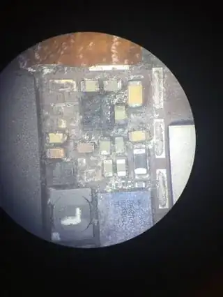

Rice does not solve water damage.
(Source: iFixit)
When we put a phone in rice, it is the same thing as doing nothing. It just FEELS like we're actively trying something. Corrosion is instant when a phone hits water. Sometimes the corrosion hits important components, sometimes not. If we resist turning the phone on until it dries on the counter, in the rice bag, or anywhere else, sometimes we get lucky. If we had the phone in the rice bag, we think the rice saved the phone. But it didn't! Even if the phone seems to be working, it will have oxidized solder joints that are weakened and brittle. Corrosion will continue to spread inside the phone. We have done nothing but experienced temporary luck.
You have to take it to a repair shop that has an ultrasonic cleaner or follow the advice from iFixit.
What you want to do is first displace the water—or more specifically, all the conductive stuff in the water. You can do this best by using 90%+ isopropyl (rubbing) alcohol and a toothbrush. Open your device as soon as you can, take out the battery, and get scrubbing. Submerge the whole motherboard in alcohol, and scrub away. Only then, dry it and see where you stand. This is your best strategy for liquid damage.
You'd be hard pressed to find any experienced professional in the repair industry that doesn't roll their eyes when they hear the word "rice." We see the sad result of phones/devices that have been carefully placed in the Mahatma bag with fingers crossed.
How is rice supposed to remove this damage? Imagine even rubbing the rice on the circuit board. Would that do anything? NO. So that's why putting your phone in a bag of rice would NOT help.
corroded chip
Chip after rice cure (click to enlarge)
