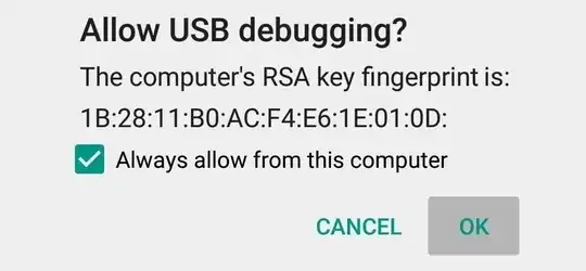

P.s. Here's a preview of what should be showing up on my own android device but is not:

  • By the way, I tried using these articles to solve the issue, but to not avail.
    1. https://android.stackexchange.com/questions/101933/galaxy-s4-does-not-show-authorize-usb-debugging-dialog-box
    2. https://android.stackexchange.com/questions/144507/cant-authorise-android-device-in-usb-debugging-mode
    – dev-segal Jul 02 '19 at 23:12
  • It's not yet mentioned, but the first thing to check is if the USB cable you're using is a data cable, not only a charging cable, i.e. that the device is detected by the computer first and you can browse the content of the smartphone's external storage from the PC. Also, you haven't mentioned the OS of the computer, but assuming it's Windows, then you probably need to install OEM USB drivers. – Andrew T. Jul 03 '19 at 02:28
  • Thanks for sharing the info about the data cable, appreciate it. I actually figured out the cause of the issue: It seems like the profile of the computer(perhaps the RSA key fingerprint) was automatically recognized by the android device and so it didn't ask for any permissions. From there, I'm still kind of trying to understand it. But basically, as soon as I reset(factory reset) my computer, it started prompting me for authorization again. I'm sure the factory reset was on the extreme end of options, but it worked in the end. – dev-segal Jul 03 '19 at 04:22
  • Hello. I appreciate that you found the answer yourself, but please note that this is a Q&A site so we keep questions as questions strictly. Consider posting your solution as an answer in the space provided above the bottom of this page. As for others who visit this question in the future and finds the absence of a solution, visit this edit from OP. – Firelord Jul 03 '19 at 19:45
  • Alright, thanks for letting me know. – dev-segal Jul 03 '19 at 21:51
There's an option called "Revoke USB Authorization" within the Developer options. Click it and it'll revoke the auth key.
