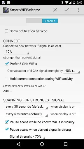

You can take advantage of the experimental "prefer 5 GHz" feature from WiFi band – or Smart WiFi Selector, which offers that as well:
WiFi Band SmartWifiSelector
WiFi Band / Smart WiFi Selector (source: Google Play; click images for larger variants)

    Smart WiFi Selector promises that. Just tried it, boosting the 5GHz preference to its strongest value. No dice, device still sits on the 2.4GHz. But I had to re-enter the wifi password twice now. Nasty. // PS: Emtpy promise. Didn't do a thing on the test device, it still connects the 2.4GHz only. Not sure whether the app simply doesn't work, or my test device doesn't like it – as it's already the second one without any effect. – Izzy Jun 16 '18 at 22:18
  • Forget my test device. Who'd thought my Wileyfox Swift (2016) was 2.4GHz only, while my LG P880 (2013) connects 5Ghz as well (and without being fooled to it)? Now I need to figure which of the other devices have the same reason… And no, please keep the answer (I've already upvoted it). You got it started, I just jumped at your triggers :) Though you might wish to remove the MIUI part: that's not fitting "prefer 5GHz over 2.4", but "force it to 5GHz only", and thus not meeting the Q's requirements (contradicitng bullet-point #2), which makes it misleading. – Izzy Jun 17 '18 at 17:38
