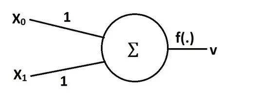

Consider a perceptron where $w_0=1$ and $w_1=1$:
Perceptron
Now, suppose that we use the following activation function
\begin{align} f(x)= \begin{cases} 1, \text{ if }x =1\\ 0, \text{ otherwise} \end{cases} \end{align}
The output is then summarised as:
\begin{array}{|c|c|c|c|} \hline x_0 & x_1 & w_0x_0 + w_1x_1 & f( \cdot )\\ \hline 0 & 0 & 0 & 0 \\ \hline 0 & 1 & 1 & 1 \\ \hline 1 & 0 & 1 & 1 \\ \hline 1 & 1 & 2 & 0 \\ \hline \end{array}
Is there something wrong with the way I've defined the activation function?

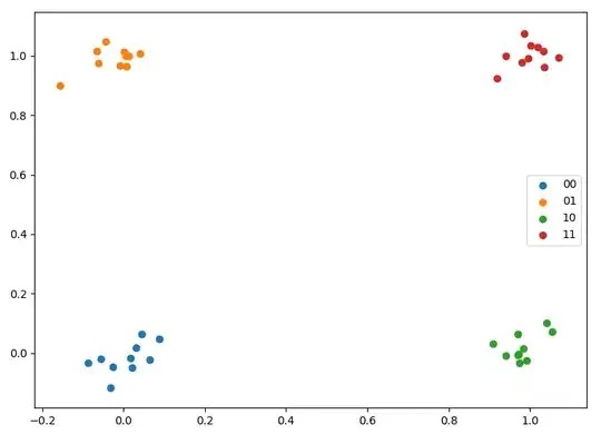

For training, I take a few points randomly scattered around $[0, 0]$, $[0, 1]$, $[1, 0]$, and $[1, 1]$.
n = 10
sd = [0.05, 0.05]
x00 = np.random.normal(loc=[0, 0], scale=sd, size=(n,2))
x01 = np.random.normal(loc=[0, 1], scale=sd, size=(n,2))
x10 = np.random.normal(loc=[1, 0], scale=sd, size=(n,2))
x11 = np.random.normal(loc=[1, 1], scale=sd, size=(n,2))
x = np.vstack((x00,x01,x10,x11))
y = np.vstack((np.zeros((x00.shape[0],1)),
               np.ones((x01.shape[0],1)),
               np.ones((x10.shape[0],1)),
               np.zeros((x11.shape[0],1)))).ravel()
ind = np.arange(len(y))
np.random.shuffle(ind)
x = x[ind]
y = y[ind]
N = len(y)
plt.scatter(*x00.T, label='00')
plt.scatter(*x01.T, label='01')
plt.scatter(*x10.T, label='10')
plt.scatter(*x11.T, label='11')
plt.legend()
plt.show()

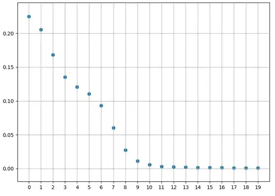

The training error is decreasing:
plt.scatter(np.arange(n_epochs), error)
plt.grid()
plt.xticks(np.arange(0, n_epochs, step=1))
plt.show()

Result:
RMSE 0.09199468888373698
r2_score 0.9613632278609362
