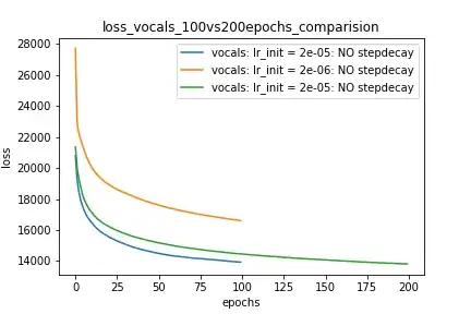

Setup-1 Results:
Here I'm NOT decaying the learning rate and
I'm using the same Adam optimizer. So my results are as expected.
My loss decreases with more epochs.
Below is the loss plot this setup.
Plot-1:
Setup-1 Results

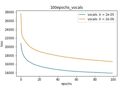

Setup-2 Results:
Here I'm NOT decaying the learning rate but every epoch I'm creating a new
Adam optimizer with the same initial parameters.
Here also results show similar behavior as Setup-1.
Because at every epoch a new Adam optimizer is created, so the calculated gradients
for each parameter should be lost, but it seems that this doesnot affect the
network learning. Can anyone please help on this?
Plot-2:
Setup-2 Results

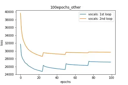

Setup-3 Results:
As can be seen from the results in below plot,
my loss jumps every time I decay the learning rate. This is a weird behavior.
If it was happening due to the fact that I'm creating a new Adam
optimizer every epoch then, it should have happened in Setup #1, #2 as well.
And if it is happening due to the creation of a new Adam optimizer with a new
learning rate (alpha) every 25 epochs, then the results of Setup #4 below also
denies such correlation.
Plot-3:
Setup-3 Results

Setup-4 Results:
In this setup, I'm using Pytorch's learning-rate-decay scheduler (multiStepLR)
which decays the learning rate every 25 epochs by 0.25.
Here also, the loss jumps everytime the learning rate is decayed.
As suggested by @Dennis in the comments below, I tried with both ReLU and 1e-02 leakyReLU nonlinearities. But, the results seem to behave similar and loss first decreases, then increases and then saturates at a higher value than what I would achieve without learning rate decay.
Plot-4 shows the results.

I see no reason why decaying learning rates should create the kinds of jumps in losses that you are observing. It should "slow down" how quickly you "move", which in the case of a loss that otherwise consistently shrinks really should, at worst, just lead to a plateau in your losses (rather than those jumps).
The first thing I observe in your code is that you re-create the optimizer from scratch every epoch. I have not yet worked enough with PyTorch to tell for sure, but doesn't this just destroy the internal state / memory of the optimizer every time? I think you should just create the optimizer once, before the loop through the epochs. If this is indeed a bug in your code, it should also actually still be a bug in the case where you do not use learning rate decay... but maybe you simply get lucky there and don't experience the same negative effects of the bug.
For learning rate decay, I'd recommend using the official API for that, rather than a manual solution. In your particular case, you'll want to instantiate a StepLR scheduler, with:
  • optimizer = the ADAM optimizer, which you probably should only instantiate once.
  • step_size = 25
  • gamma = 0.25
You can then simply call scheduler.step() at the start of every epoch (or maybe at the end? the example in the API link calls it at the start of every epoch).
If, after the changes above, you still experience the issue, it would also be useful to run each of your experiments multiple times and plot average results (or plot lines for all experiments). Your experiments should theoretically be identical during the first 25 epochs, but we still see huge differences between the two figures even during those first 25 epochs in which no learning rate decay occurs (e.g., one figure starts at a loss of ~28K, the other starts at a loss of ~40K). This may simply be due to different random initializations, so it'd be good to average that nondeterminisim out of your plots.
