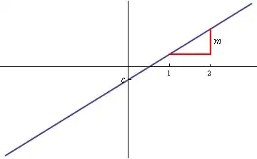

Let's see your problem from a different viewpoint. Why are you thinking only of integers? Your problem can be generalised to approximating this curve:
This is clearly an example of $W.T * X + B$. Single input node will feed into 2 output nodes of Leaky ReLu activation, and a bias node. The bias node will be your $c$ and the 2-3 Leaky ReLu's will adjust their weights to create a straight line. Training this might be a problem (with co-adaptation between nodes), but mathematically a solution will be achieved by this Neural Net structure.
Also it is better to train on real values also, for better and finer weight adjustment (although theoretically for a single independent variable $x$ you should just need 3-4 values to make this Neural Net learn, but who knows?)
NOTE: The approximation in the negative region might not be that great.
