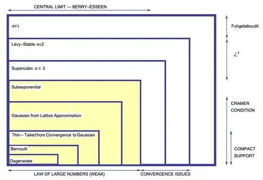

Yes, Taleb is right. There are practical and mathematical limits even an AI, no matter how powefull, cannot overcome. Taleb point is that some events are inherently unpredictable. The amount of data the we would need to correctly guess their distribution is so massive we could never build a machine large enough that would run for long enough to provide accurate predictions:
Quote (and above image) from Taleb book on Statistical Consequences of Fat Tails (emphasis mine)
Once we leave the yellow zone, where the law of large numbers (LLN) largely works, and the central limit theorem (CLT) eventually ends up workin, then, we encounter convergence problems.
Further up, in the top segment, there is no mean. We call it the Fuhgetaboudit. If you see something in that category, you go home and you don’t talk about it.
The traditional statisticians approach to thick tails has been to claim to assume a different distribution but keep doing business as usual, using same metrics, tests, and statements of significance. Once we leave the yellow zone, for which statistical techniques were designed (even then), things no longer work as planned. The next section presents a dozen issues, almost all terminal.
Moreover, consider that not only you need a huge amount of data, but also that the interesting data-points for extremely rare events happen, as their name indicates, extremely rarely. So you might have to wait a literal eternity to ever have enough data to train the AI to make a prediction.
That said, even while AI cannot escape the mathematical boundaries that make prediction of extreme events impossible, it might perhaps be able to learn to do what Taleb recommends us to do: When dealing with extreme events, avoid prediction, and instead come up with approaches that make allow you to survive regardless lack of predictive power.
