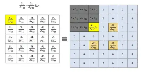

Animation of backpropagation with stride > 1
Backpropagation with stride > 1 involves dilation of the gradient tensor with stride-1 zeroes. I created a blog post that describes this in greater detail.
