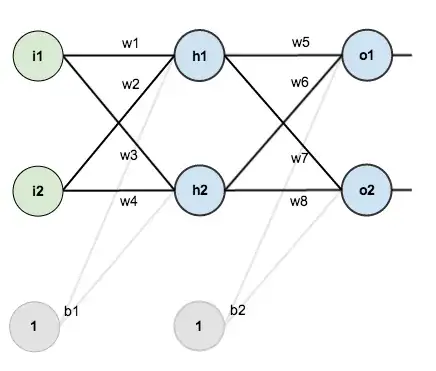

I understood most parts of backpropagation, but how do we get the gradients for the middle layer weights $dL/dw_1$?
How should we calculate the gradient of a network similar to this?
Is this the correct equation?
$$\frac{\partial L}{\partial w_{1}}=\frac{\partial h_{1}}{\partial w_{1}} \frac{\partial w_{7}}{\partial h_{1}} \frac{\partial o_{2}}{\partial w_{7}} \frac{\partial L}{\partial o_{2}}+\frac{\partial h_{1}}{\partial w_{1}} \frac{\partial w_{5}}{\partial h_{1}} \frac{\partial o_{1}}{\partial w_{5}} \frac{\partial L}{\partial o_{1}}$$

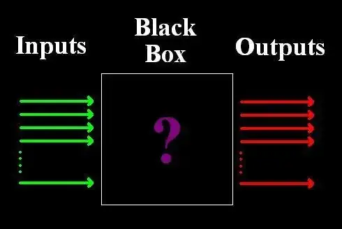

Now that we know how the chain rule works, let's see how we can use it in Machine Learning. So basically in machine learning, the final output is a function of input variables and the connection weights $f\left(x_1, x_2, \ldots, x_n, w_1, w_2, \ldots, w_n\right)$, where $f$ encloses all the activation functions and dot products lying between input and output. The $x_1, x_2, \ldots, x_n, w_1, w_2, \ldots, w_n$ are called independent variables because they don't affect each other pairwise as well as in groups meaning you cannot find a function $g(x_i, \dots, w_i, \dots) = h(x_j, \dots, w_j, \dots)$. So, basically its a black box from input to output.

To answer your question the equation is incorrect and the correct equation will be:
$$ \frac{\partial L}{\partial w_{1}}=\frac{\partial h_{1}}{\partial w_{1}} \frac{\partial o_{2}}{\partial h_{1}} \frac{\partial L}{\partial o_{2}}+\frac{\partial h_{1}}{\partial w_{1}} \frac{\partial o_{1}}{\partial h_{1}} \frac{\partial L}{\partial o_{1}} $$
I have simply followed the algorithm I have given above.
As for why your equation is wrong, your equation contains the term $dw7/dh1$. Does $w_7$ vary with $h_1$? This means that $w_7$ is directly related to the input as $h_1$ is related with the input, but this is not the case for a single iteration(the whole algorithm run makes $w_n$ dependent on the inputs since you are trying to minimize the loss function w.r.t given inputs and weights, for a different set of inputs you will have different final weights).
So, in a nutshell, the aim of back-propagation is to identify the change in the loss function w.r.t to a given weight. To calculate that, you have to make sure in the chain rule of derivative you don't have any meaningless terms like the derivative of an independent variable w.r.t to any function. I recommend checking Khan Academy for a better understanding and clarity in concepts as I think the intuitions are hard to provide in a written answer.

  • Thanks I got it w7 and w5 are constants whereas h1 and o1 are functions. w7 and w5 only changes during updation whereas h1 and o1 changes in forward passing aswell – Eka Mar 10 '18 at 16:13
    @Eka good..I missed that part but you got it –  Mar 10 '18 at 16:16
  • One other question; so when we are finding gradients with respect to a weight. We keep that weight as variable and the rest of weights as constant. in my above case w1 is variable and the other two constant.. right? – Eka Mar 10 '18 at 16:28
    @Eka yes...that is pretty much the concept of how partial derivatives are calculated –  Mar 10 '18 at 16:38
