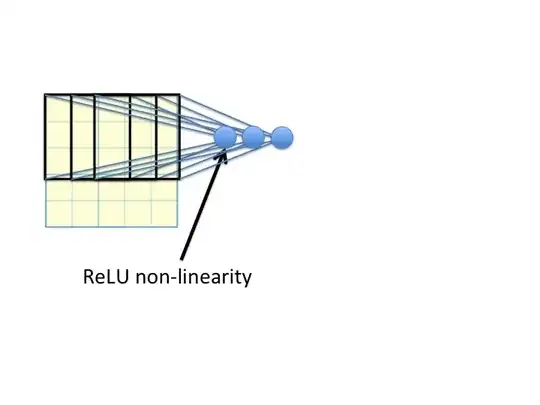

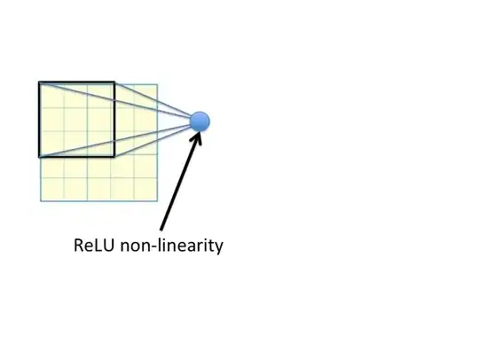

The problem is in your diagram. Here are the steps to get to a 5x5 receptive field. Here is your diagram, redone slightly: The 3x3 input field is summed up (by the weights), and passed through a nonlinear activation function
Notice that the new unit takes a weighted sum of the 9 pixels in the input, and then applies a rectified linear nonlinearity. Now, there are more of these, creating three new numbers computed from that part of the image. Each one slides over by one pixel:
We repeat this process going down three pixels as well, and then finally, we have a new 3x3 input field:
Notice that the new unit on the right now gets input from a 5x5 input field. I hope this helps!
