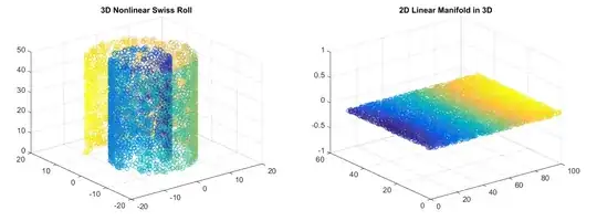

In the context of machine learning, the concept of a manifold can be illustrated as in the following figure.
swiss
In the first part, data are 3-dimensional. However, we can find a transformation to get the second image, which shows that data is actually artificially high dimensional, i.e. it is a 2-dimensional manifold in 3-D space. This example may be thought of as a classification problem, and colors may represent classes, and we can find a trivial representation of the data for classification.

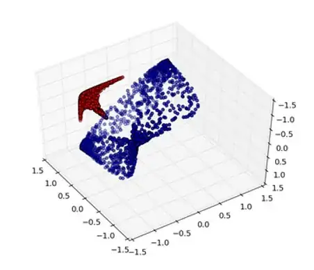

Another example could be following figures from the blog I mentioned. In here, this classification problem cannot be solved without having a layer that has 3 or more hidden units, regardless of depth. So the notion of high dimensional transformation is important.
1st image
We can map this data to 3-D, and find a plane to separate them.
2nd iamge
