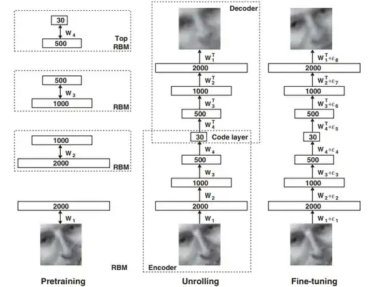

RBM for dimensionality reduction
RBM can be used to perform dimensionality reduction, and those hidden vectors are some abstract representations of the raw inputs:
According to the paper Reducing the Dimensionality of Data with Neural Networks
In 2006, a breakthrough in feature learning and deep learning took place (Hinton et al., 2006; Bengio et al., 2007; Ranzato et al., 2007), A central idea, referred to as greedy layerwise unsupervised pre-training, was to learn a hierarchy of features one level at a time, using unsupervised feature learning to learn a new transformation at each level to be composed with the previously learned transformations; essentially, each iteration of unsupervised feature learning adds one layer of weights to a deep neural network. Finally, the set of layers could be combined to initialize a deep supervised predictor, such as a neural network classifier.
Summary
  1. Train single layer RBM to reconstruct to input and then keep adding layer after layer until we reach some good low-level representation as depicted in the figure below, W1, W2, W3 are the matrices that have some lower dimensionality of the input space.
  2. Transpose those matrices $W_1, W_2, W_3$ to be the decoder part.
  3. Fine-tune the whole encoder-decoder stack to reconstruct the input. image
