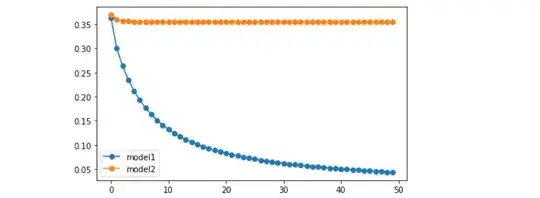

Running this optimization for 50 epochs and collecting loss history:
optimizer1 = torch.optim.SGD(model1.parameters(), lr=0.01)
optimizer2 = torch.optim.SGD(model2.parameters(), lr=0.01)
losses1, losses2 = [] , [] for _ in range(50): losses1.append(optimize_epoch(model1, optimizer1)) losses2.append(optimize_epoch(model2, optimizer2))
plot(losses1, label="model1"); plot(losses2, label="model2"); legend()
You'll see a striking difference in performance between the two models:
Enter image description here

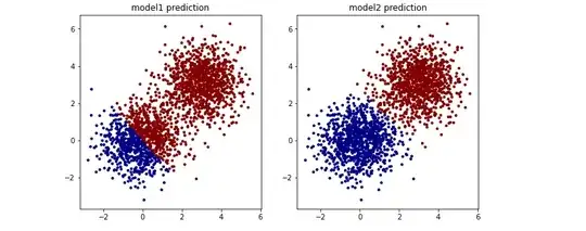

As per @Stef request, here are the scatterplots for predicted classes for each model. Obtainable via scatter(x[:,0], x[:,1], c=model1.forward(x).argmax(axis=1).
Here you can clearly see that the separating line for bias=False goes through (0,0) in accordance with most of other answers here.
Kostya
  • 2,515
  • I think this experiment would be much much more visually striking if you showed the result as the predicted classes on your scatterplot, rather than just a loss curve. – Stef Mar 13 '23 at 14:22
    @Stef added. Thank you for feedback. – Kostya Mar 13 '23 at 15:47
