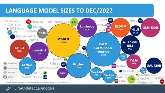

So far I've found the ChatGPT 3.5 model to have 175 billion parameters:
Though I do not yet know how large that is in Mb nor do I have an idea on how long generating an output would typically take.
