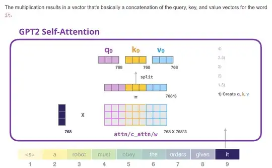

In the explanation from the same author of GPT-2 (this model has an embedding dimension of 768 and 12 Attention-Heads, instead of 512 and 8 like the original Transformer) found here https://jalammar.github.io/illustrated-gpt2/#part-2-illustrated-self-attention
the Queries Q, Keys K and Values V are first calculated by multiplying the input with one big matrix which is the concatenation of $W^Q,W^K,W^V$. If the input for calculating Q, K and V is identical (which is the case for self-attention), it is clear to me that you can use $W_{concat}=[W^Q,W^K,W^V]$ and obtain $[Q,K,V]$, since you essentially still multiply the input with each weight matrix separately.
Then you can split the result to again obtain $Q,K,V$ as individual matrices (The image displays $q_9,k_9,v_9$ as an example, not the complete matrices). Then $q_9,k_9,v_9$ are again split into 12 vectors which results in a matrix of dimension $(12x64)$.
So overall here we did not use individual matrices per Attention-Head but only one larger matrix.
Is this method mathematically identical to the one using individual smaller matrices per Attention-Head?

Therefore, it appears to me that both ways of calculations should be equal and the one using the bigger matrices is just more efficient to compute. Is this correct?

The queries, keys and values are calculated then chunked so that each chunk depends on (is a linear combination of) all values of the input embedding.

Understand MultiHeadAttentionNew first then understand MultiHeadAttentionOld, and then maybe look at the pytorch code.

  • Thank you for the link! It is really helpful. While I do not understand the details of some of the einops functions, it is clear enough. Since also bigger matrices are used in MultiHeadAttentionNew it really seems that you can just use bigger matrices and it gets you the same result.
