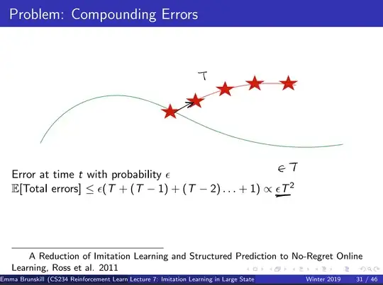

This is a case of overfitting the Q function leading to compounding errors when selecting actions.
  1. You have been training your policy for too long on the same data distribution.
  2. Overfitting Q functions will then lead to data distribution mismatches more often in action selection and compounding errors will happen earlier than before.
You should probably train until 400 up to 600 episodes and then stop training the policy. Consider the following slide on compounding errors:
Data distribution mismatch and compounding errors
Whenever a wrong action is selected, because of overfitted Q value function, the agent can not generalize well on how to recover from that mistake. Eventually, compounding errors increase quadratically in time.
Compound errors are quadratic in time
It will only get worse for your agent once the wrong action is picked.
