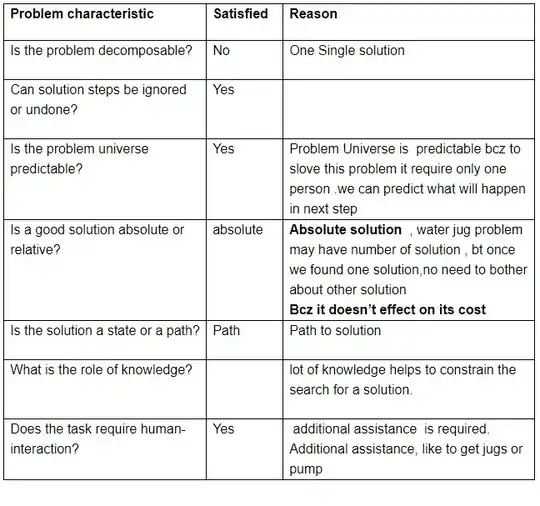

Below is an example of the 7 AI problem characteristics being applied to solve a water jug problem.
Below is an example of the 7 AI problem characteristic being used to solve a water jug problem.
Image source https://gtuengineeringmaterial.blogspot.com/2013/05/discuss-ai-problems-with-seven-problem_1818.html

  • What formally qualifies as requiring human interaction? As I'd've thought that the water jug problem doesn't require human interaction; to me the reason you gave seems like just a precondition for doing the problem in a real life (as opposed to simulated) setting.
  • If a given solution is composed of multiple steps, and you could therefore break down the search into a search from the solution to the start combined with a search from the start to the solution, is the problem not decomposable? Again, my quabble is with what formally qualifies.
  • Why is the solution not a state? ...
  • – god of llamas Apr 15 '18 at 17:19
  • ... The state of the solved bucket is the solution so to me it would seem like the solution is finding a path to the state, with the path in service to the state rather than vice versa; if the state was merely in service to the path that is the solution then I'd think the solution was the path rather than the state. – god of llamas Apr 15 '18 at 17:24
    Additionally, your answer doesn't seem to fully answer the question posed: "Is there a generally accepted relationship between placement of a problem along these dimensions and suitable algorithms/approaches to its solution?" – god of llamas Apr 15 '18 at 17:29
