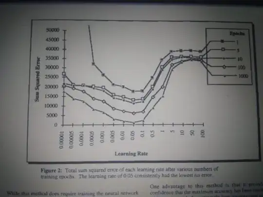

I once read somewhere that there is a range of learning rate within which learning is optimal in almost all the cases, but I can't find any literature about it. All I could get is the following graph from the paper: The need for small learning rates on large problems
In the context of neural networks trained with gradient descent, is there a range of the learning rate, which should be used to reduce the training time and get a good performance in almost all problems?

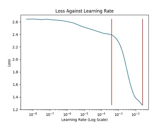

Here is a concrete example from one of my experiments:
Learning Rate Finder Loss Plot
In this case, I start my learning rate search at 1e-09 and plan to end with a learning rate of 0.99 (although I am actually able to stop sooner than that). Your experiment may require different search bounds, but you could always start with that and adjust things as needed. At first, the loss plot is flat, and then it begins to decrease, but is too gradual. At the first red line, loss starts to decrease sharply, and once it reaches the second red line, the plot has begun to level off, so I can end my search. For this particular experiment, my ideal learning rate range had a minimum of 4.01e-4 and a maximum of 2.58e-2.
For more information, I suggest reading this Keras Learning Rate Finder post, which contains more information on how the process works and a tutorial for how to program it using Keras and Tensorflow.

The visualisation can be found in The need for small learning rates on large problems. This paper by D. Randall Wilson and Tony R. Martinez from 2001 investigates the role of learning rates in gradient descent algorithms.
