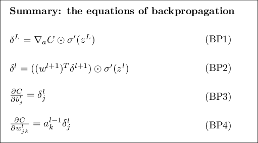

Consider the backprop equations as defined by this online book:
The gradient of the current layer's weights depends on
  1. The future layers' weights, errors, and activation function's derivatives
  2. The current layer's activation function's derivative, and
  3. The previous layer's outputs.
Each weight in the layer (i.e. each filter in the layer) looks at different parts of these three components (indexed by $j$ and $k$ in equation $BP4$). It is this different perspective that allows them to update their gradients in different directions, even if their initial weights are very similar to each other. Note that it is possible that they end up with the same gradient, but it is very unlikely.
