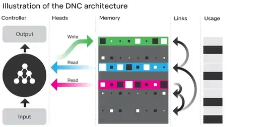

Examining the architecture of the DNC indeed shows many similarities to the LSTM. Consider the diagram in the DeepMind article that you linked to:
DeepMind DNC Architecture

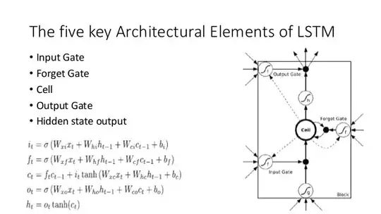

Compare this to the LSTM architecture (credit to ananth on SlideShare):
There are some close analogs here:
  • Much like the LSTM, the DNC will perform some conversion from input to fixed-size state vectors (h and c in the LSTM)
  • Likewise, the DNC will perform some conversion from these fixed-size state vectors to potentially arbitrarily-lengthed output (in the LSTM we repeatedly sample from our model until we are satisfied/the model indicates we are done)
  • The forget and input gates of the LSTM represent the write operation in the DNC ('forgetting' is essentially just zeroing or partially zeroing memory)
  • The output gate of the LSTM represents the read operation in the DNC
However, the DNC is definitely more than an LSTM. Most obviously, it utilizes a larger state which is discretized (addressable) into chunks; this allows it to make the forget gate of the LSTM more binary. By this I mean that the state is not necessarily eroded by some fraction at every time step, whereas in the LSTM (with the sigmoid activation function) it necessarily is. This might reduce the problem of catastrophic forgetting that you mentioned and thus scale better.
The DNC is also novel in the links that it uses between memory. However, this might be a more marginal improvement on the LSTM than it seems if we re-imagine the LSTM with complete neural networks for each gate instead of just a single layer with an activation function (call this a super-LSTM); in this case, we can actually learn any relationship between two slots in memory with a sufficiently powerful network. While I don't know the specifics of the links that DeepMind is suggesting, they imply in the article that they are learning everything just by backpropagating gradients like a regular neural network. Therefore whatever relationship they are encoding in their links should theoretically be learnable by a neural network, and so a sufficiently powerful 'super-LSTM' should be able to capture it.
