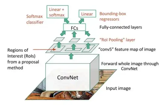

I read so many articles and the Fast R-CNN paper, but I'm still confused about how the region proposal method works in Fast R-CNN.
As you can see in the image below, they say they used a proposal method, but it is not specified how it works.
What confuses me is, for example, in the VGGnet, the output of the last convolution layer is feature maps of shape 14x14x512, but what is the used algorithm to propose the regions and how does it propose them from the feature maps?

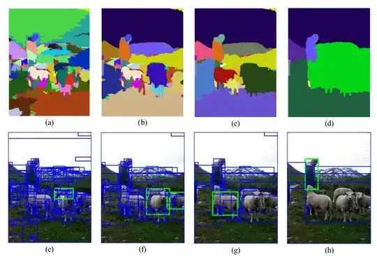

The algorithm is based on a series of segmentation and aggregation techniques of the input image for generating the proposed regions. Check it out 4 iterations of segmentation & aggregation over the same input image to build the proposed regions.
All the algorithm is doing is just iterating over 4 steps:
  1. Initial regions based on segmentation by pixel light intensity are obtained by applying a segmentation algorithm described in the paper. For example, given a picture of a shepherd with his sheep in the mountain, it is segmented by light intensity, and the image of Figure (a) is obtained.
  2. Different regions are proposed based on the previous segmentation, Figure (e)
  3. The similarity between the proposed regions is calculated using the formula proposed in equation 6 in Section 3.2 in the paper which is nothing more than an aggregate metric of the similarity of two regions based in 4 metrics: similarity in color, texture, size and fill (measures how well a region within another)
  4. Add the regions based on similarity and get Figure (b). Then return to step two.
That is how iteratively you get all the images depicted.

    This answer is nice (because it visually shows what you mean by "segmentation + aggregation"), but it doesn't describe how "selective search" actually proceeds. So, to improve this answer, I would suggest that you attempt to describe "selective search" slightly more in detail (maybe provide the pseudocode, if it exists?), so that people when reading your answer (which could serve as a reference) have a more detailed idea than "segmentation + aggregation", which is somehow explained by the images that you show us. – nbro Feb 03 '21 at 17:20
    yep, you re right, already updated :) – JVGD Feb 04 '21 at 10:47
  • Maybe the only thing that is missing in your answer would be an answer to this question "And how is the size of these proposed regions calculated?". – nbro Feb 04 '21 at 10:52
  • The intuitive approach on how the regions are calculated is easy to express with words but not that easy mathematically speaking. For a true description the algorithm is explained in the paper (algorithm 1) but I feel that if we were to describe it in here it would make this answer very big – JVGD Feb 04 '21 at 12:45
