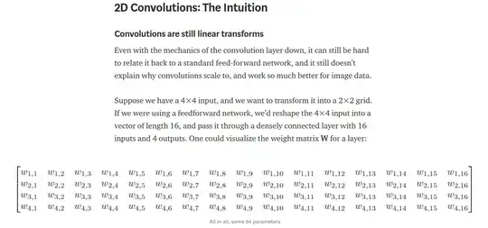

The image above, a screenshot from this article, describes discrete 2D convolutions as linear transforms. The idea used, as far as I understand, is to represent the 2 dimensional $n$x$n$ input grid as a vector of $n^2$ length, and the $m$x$m$ output grid as a vector of $m^2$ length. I don't see why this can't be generalised to higher-dimensional convolutions, since a transformation matrix can be constructed from one vector to another, no matter the length (right?)
My question: Aren't all discrete convolutions (not just 2D) linear transforms?
Are there cases where such a transformation matrix cannot be found?

Convolution is a pretty misused term in recent times with the advent of CNN.
Short answer, Convolution is a linear operator (check here) but what you are defining in context of CNN is not convolution, it is cross-correlation which is also linear in case of images (dot product).

So these are the actual definitions of convolution. It has linearity property (clearly obvious since it is used to calculate output of LTI system), and it also has the linearity in terms of matrix multiplications, since we want to do the computer to do these calculations for us. I don't know a lot but there are many clever manipulations e.g the FFT algorithm an indispensable tool in signal processing (used to convert signals to frequency domain for a certain sampling rate). Like this you can define convolutions in terms of Hermitian matrices and stuff (only if you want to process in the $n$ domain it is much easier to process in the frequency domain).
For example a $1D$ circular convolution between 2 signals in $n$ domain defined in matrix form, can be written as follows $y_n=h_n*x_n$: where $$y_t = \begin{bmatrix} y_0 \\ y_1 \\ y_2 \\ y_3 \end{bmatrix} = \begin{bmatrix} h_0 & h_3 & h_2 & h_1\\ h_1 & h_0 & h_3 & h_2\\ h_2 & h_1 & h_0 & h_3 \\ h_3 & h_2 & h_1 & h_0 \end{bmatrix} \begin{bmatrix} x_0 \\ x_1 \\ x_2 \\ x_3 \end{bmatrix}$$

The convolutions are linear transformations. However in typical applications a non linear activation function like RELU is used following the convolution to provide non-linearity otherwise a convolutional neural network would just be a net linear transformation.
