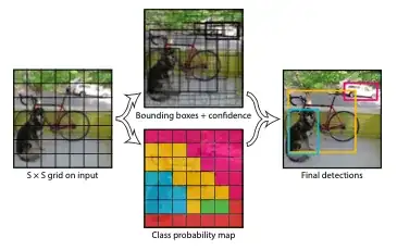

First, both frameworks treat object detection as a regression problem, each of them outputs a tensor that can be seen as a grid with cells (below is an example of an output grid).
Yolo V1 Grid cell

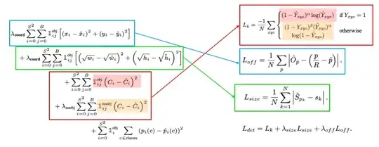

The loss functions have near the same structure (see above) except that L1 is preferred in CenterNet while Yolo uses L2, among other subtleties.
