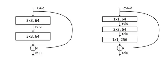

From the paper:
Observe: it's taking some of the layer outputs from earlier layers and passing their outputs further down and element wise summing these with the the outputs from the skipped layers. These blocks may learn mappings that are not the identity map.
From paper (some benefits):
$$\boldsymbol{y} = \mathcal{F}(\boldsymbol{x},\{W_i\})+\boldsymbol{x}\quad\text{(1)}$$The shortcut connections in Eqn.(1) introduce neither extra parameter nor computation complexity. This is not only attractive in practice but also important in our comparisons between plain and residual networks. We can fairly compare plain/residual networks that simultaneously have the same number of parameters, depth, width, and computational cost (except for the negligible element-wise addition).
An example of a residual mapping from the paper is $$\mathcal{F} = W_2\sigma_2(W_1\boldsymbol{x})$$
That is $\{W_i\}$ represents a set of i weight matrices ($W_1,W_2$ in the example) occurring in the layers of the residual (skipped) layers. The "identity shortcuts" are referring to performing the element wise addition of $\boldsymbol{x}$ with the output of the residual layers.
So using the residual mapping from the example (1) becomes:
$$\boldsymbol{y} = W_2\sigma_2(W_1\boldsymbol{x})+\boldsymbol{x}$$
In short, you take the output $\boldsymbol{x}$ of a layer skip it forward and element wise sum it with the output of the residual mapping and thus produce a residual block.
