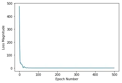

I found a solution to this some time back. I have been studying function approximation (within linear regression) for some time. Here's how I did it:
Neural Networks have been proved to be universal function approximators. So, even a single hidden layer would be sufficient to approximate a function simple as addition (Even somewhat complex functions like the Sine and any random CONTINUOUS wiggly function have been approximated)
First, I used a high level API like TensorFlow and Keras and implemented it here
The model was trained on the data (input-output pairs)
R    = np.array([-4, -10,  -2,  8, 5, 22,  3],  dtype=float)
B    = np.array([4, -10,  0,  0, 15, 5,  1],  dtype=float)
G    = np.array([0, 10,  5,  8, 1, 2,  38],  dtype=float)
Y    = np.array([0, -10, 3, 16, 21, 29, 42],  dtype=float)
And trained as follows:
#Create a hidden layer with 2 neurons
hidden = tf.keras.layers.Dense(units=2, input_shape=[3])
#Create the output (final) layer which symbolises value of **Y**
output = tf.keras.layers.Dense(units=1)
#Combine layers to form the neural network and compile it
model = tf.keras.Sequential([hidden, output])
model.compile(loss='mean_squared_error', optimizer=tf.keras.optimizers.Adam(0.1))
history = model.fit(RBG,Y, epochs=500, verbose=False)
The model converges in about 50 epochs
Also, I have implemented the same using only C/C++ and used GNU plot to visualize the results.
