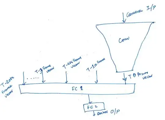

Feed forward CNN
Or Is it something like the below?
Something like this from my imagination
Or are they using something like Many to one Recurrent net where inputs are CNN vectors of previous few frames and output is the control?
It varies quite substantially between different self-driving paradigms(rather obviously) but for the most part the vast majority of implementations are using a variety of different reference frames in order to make predictions.
For example, Tesla's Autopilot is being fed many different camera feeds as well as radar and ultrasonic signals that are processed in a variety of temporal contexts.
While, for the most part, all of these programs are very tight-lipped, we can make a variety of assumptions based on the information available and educated assumptions.
As with many large, complex ML/AI systems, there is a large amount of compartmentalization where many different connectionist(or sometimes classic) models are combined(à la youtube recommendation system). Tesla is likely utilizing recurrent and convolutional networks where particular modules(combinations of models) are deciding on specific contexts(temporal or signal-based). These outputs are then most likely fed into an actor network which makes real time decisions.

Visualization Appreciated
The diagrams are nicely thought out. As you refine your comparative design visualizations, you might use something like Inkscape to draw them for web publication, whether or not you decide to submit a paper to a publisher or license your ideas Creative Commons.

As is often the case, convolution kernel use in a CNN is likely to be the best design to recognize edge, contour, reflectivity, and texture features in collide-able object detection.
Assembly of trajectories (as a somewhat ethereal internal intermediate result) and subsequent determination of beeping, steering, acceleration, breaking, or signaling is likely best handled by recurrent networks of some type, the most publicly touted being b-LSTM or GRU based networks. The attention based handling and preemption discussed in many papers regarding real time system control are among the primary candidates for eventual common use among the designs. This is because changes in focus is common during human driving operations and is even detectable in birds and insects.
