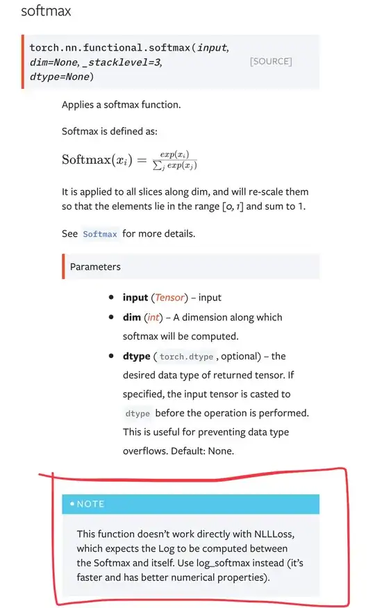

I don’t know the implementation details under the hood in PyTorch, but see the screenshot below from the documentation:

  • @user1024 this seems like a question for the development team since it could depend heavily on their implementation. But you mentioned you used softmax + nll_loss together. Note that since log is monotonically increasing, maximizing the log of the probability with respect to theta is the same as maximizing the probability with respect to theta. That is they both have the same argmax. But log likelihood expects log probabilities, this log_softmax is used. Also note that log(a/b) = log(a) - log(b). But since b is the same for all classes, it’s (probably) omitted in their implementation. – Hanzy May 01 '19 at 04:33
  • @user1024 omitted because it wouldn’t affect the maximization, so I assume it would make it faster and more numerically stable. But I also assume they have further optimized the routine implementation in ways that aren’t as obvious simply for speed and stability performance. – Hanzy May 01 '19 at 04:34
  • @user1024 and assuming that we are using a Gaussian prior, then maximizing the likelihood requires us to take an exponentiation, but taking the log cancels out the exponentiation, which would also make it faster and more stable. – Hanzy May 01 '19 at 04:36
